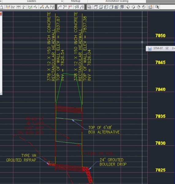

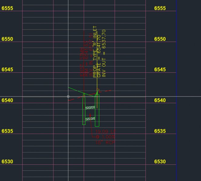

I have a style i dragged and dropped from an older drawing into this drawing. I am not getting the same results of location. basically, i am getting this;
however, i want this;
notice the different locations of the insertion. the first pic the line is inside the structure. the second image the line is offset from the top of the structure. another thing is when i insert the label, the text drops all the way to a zero "Y"
