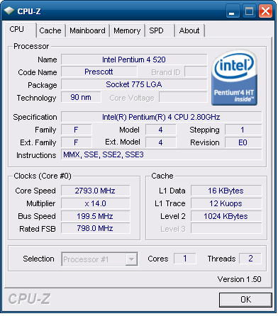

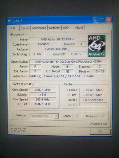

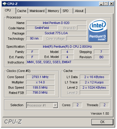

woodman78 Posted September 12, 2011 Author Posted September 12, 2011 sinc, Thank you for the very comprehensive answer. I appreciate that you took the time to write that for me. I did a CPU-Z on the pc I currently have (Pentium 4) and the 2 possibilities I have. These are the results. I did notice the core speed on the AMD jump to over 2000 when I opened some software. Don't know if that means anything? I hope this make things clearer. Thanks again. Quote
sinc Posted September 13, 2011 Posted September 13, 2011 Those were hot chips... in 2005! The Pentium 4 520 is not even 64-bit capable, so it should definitely be discarded (you want Win 7 x64). I believe the 4200+ was a direct competitor to the Pentium D 840, which was a bit better than your 820, so the AMD would probably yield the best performance of those three. But personally, I wouldn't consider any of them usable, and any money spent on upgrading them is mostly-wasted. Instead, I'd pump that money into a new computer purchase. Quote
