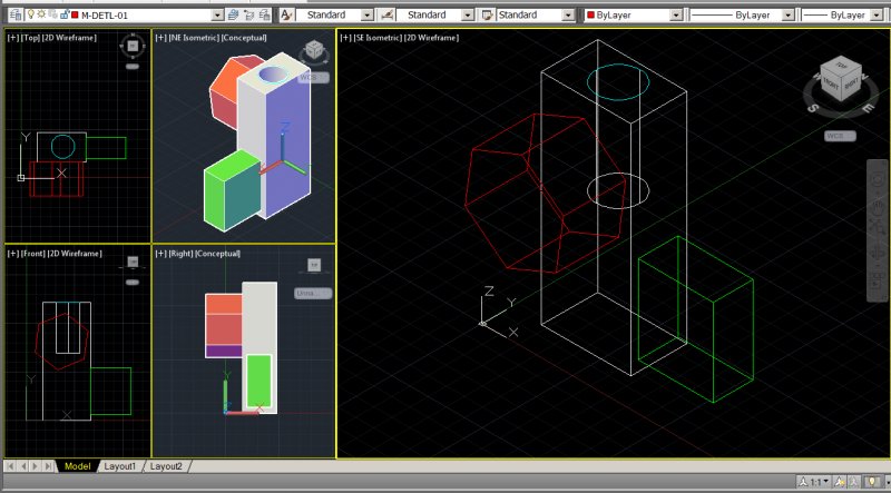

rkent Posted September 10, 2011 Posted September 10, 2011 This is my first time drawing a framed house in 3D,but I've drawn 3d objects before. The studs and my doors move out of place when I use shift + mouse wheel to turn my drawing. Are you modeling with multiple viewports in model space? That is the best way to ensure you are actually placing objects where you think you are. Set up 3 viewports with one large one in the vertical and two to the left or right of that. The large view can be your iso view and the other two your top and side view, or front, etc. Use the VIEWPORTS command, when the dialog comes up, look to the bottom and find the setup drop down, pick 3d, now to the left there is a list, pick each one and a preview is shown on the right, pick the three left or three right to start. You may find you like 4 better, etc. Quote
nestly Posted September 10, 2011 Posted September 10, 2011 :(This is the first time I've ever drawn a framed house in 3d. My studs and doors move out of place when I use the shift+mouse wheel to move around the floorplan. Unlike 2D drafting, when you draw in 3D, you have to align objects in all 3 planes, not just X and Y. It sounds like you're drawing based only on X and Y, but objects are actually being placed "above" or below" the intended destination, causing them to "separate" when you change the view. Multiple viewports, as suggested by rkent, can really help to visualize what's going on, especially until you're more familiar with working in 3D. Dynamic UCS may also help by automatically creating the drawing plane based on the objects you're referencing from, but if you don't fully understand it, it can drive you crazy when positive X switches from "right" to "up" for no apparent reason. Quote
rkent Posted September 10, 2011 Posted September 10, 2011 You can also use the command -VPORTS and create all sorts of combinations and sizes, attached is one scenario I like. On the left I have the top, front, and right side views and a small iso view, on the right I have a larger iso view for working on the model. Quote
