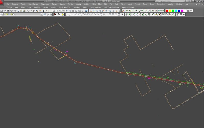

Here's my issue, (IT says the network is not the problem), I will be in a drawing working away and all of my pull down menus will change. For instance, the MAP pulldown will only display (? Export to Files). I have to do a MENULOAD, unload the current menus and reload the LAND.CUI file. I've tried saving the LAND.CUI file and renaming it to something unique and loading that file but then I lose some of my LDD tools. (the tools become ?).

So what would cause my CUI to "unload" randomly?
Nothing... commands are invoked, not spontaneous.
There must be either some sort of enterprise function(s) running, or a poorly written bit of code that is causing this. Try to see if there's a pattern to it... document (or mentally note) what you were doing immediately before said CUI is unloaded. If this is something you are invoking (albeit by mistake), knowing what you've done is the best place to start.
