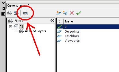

LAYERSTATE from the command line, or the 3rd button from the left in the Layer Manager
Thanks for the reply Nestly but that is where I have checked.
It's not in there....
