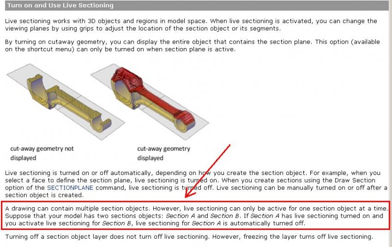

nestly Posted September 15, 2011 Posted September 15, 2011 I think the OP wants 3 different live Sectionplanes in 3 different viewports. Even if each Section plane is on it's own layer, I don't think you can control the "live" status by viewport. Quote
ReMark Posted September 15, 2011 Posted September 15, 2011 I suspect you are correct re: controlling "live' status by viewport however I have not tested that theory yet. It would be an interesting experiment though. Quote

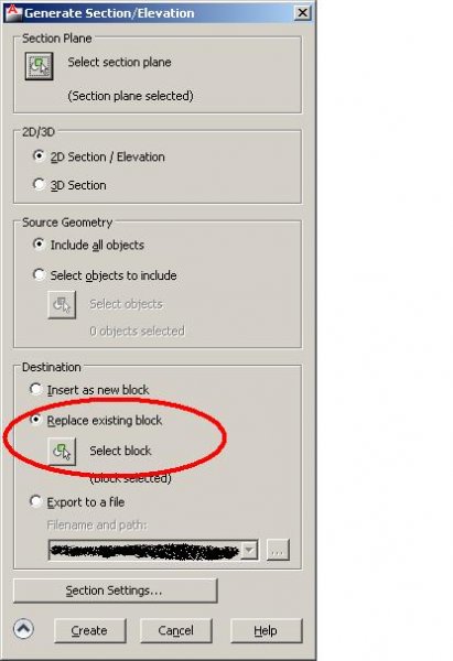

nestly Posted September 15, 2011 Posted September 15, 2011 Not possible to display more than one "live" section at a time. Use Live Section to Adject the Cross Section As far as I know, the closest you can get is to create section blocks (SECTIONPLANETOBLOCK) from your Section planes. If you change the model, just use SECTIONPLANETOBLOCK again to update the section blocks. Quote
