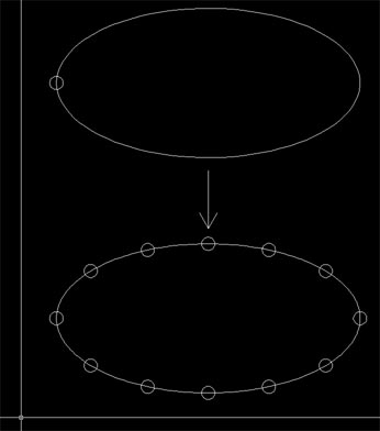

dkhoe Posted September 18, 2011 Posted September 18, 2011 I would like to arrange equally spaced circles around an ellipse. I understand I can do this with the Divide command, as referenced in a previous thread on a similar subject http://www.cadtutor.net/forum/showthread.php?50743 But I thought I could also use the Path Array command using an ellipse as the path. What I get is the replicated objects (small circles) following some totally random path. Strange that this happens only with an ellipse - seems to work OK if the path is a circle or spline. Does anyone else come up with the same problem? I'm using 2012 student edition. David Quote
Rebel Posted September 18, 2011 Posted September 18, 2011 I assume you are trying to space evenly given your example of using the divide command. I encountered your issue when the object to be arrayed was located on the top quadrant, but when I arrayed from one of the side quadrants it worked like a charm. Try putting your object on a different quadrant and array from there. edit: after a little more playing around, it seems to create a wierd path unless you place your object at the origin of the ellipse. Autocad will show you which quadrant this is after you click your ellipse to set it as the path, just follow the line from your cursor, and you will know which quadrant to put your object on for the ellipse to work correctly. Quote
nestly Posted September 18, 2011 Posted September 18, 2011 Yep, path Arrays for Ellipses are clearly broken. Quote
Rebel Posted September 19, 2011 Posted September 19, 2011 It works if you start from the left quadrant, but thats the only way I've been able to get it to work so far. Quote
nestly Posted September 19, 2011 Posted September 19, 2011 It works if you start from the left quadrant, but thats the only way I've been able to get it to work so far. [ATTACH=CONFIG]30049[/ATTACH] Not to diminish your work-a-round, but I believe it's not necessarily the "left" quadrant, rather the first point used to define the axis of the ellipse regardless of the direction relative to the center, and it still only works properly if the object being arrayed is in line with the center and the first axis point. Quote

nestly Posted September 19, 2011 Posted September 19, 2011 Here ya go Jack. I put the array object at the center, and also trimmed the ellipse. The problem seems to be the way AutoCAD locks onto the "path" but does more of a kaleidoscope thing from a single point rather than actually following it as a path. Just under-developed, IMO. Quote

dkhoe Posted September 20, 2011 Author Posted September 20, 2011 Thanks for everyone's replies and suggestions. Nestly, your videos are awesome... I ended up using the Divide command with the Block option (converted my circle into a block), but I'll keep playing around with Path Array starting with a different part of the ellipse. David Quote
Rebel Posted September 23, 2011 Posted September 23, 2011 Not to diminish your work-a-round, but I believe it's not necessarily the "left" quadrant, rather the first point used to define the axis of the ellipse regardless of the direction relative to the center, and it still only works properly if the object being arrayed is in line with the center and the first axis point.Correct. I called it left in my second post only because it happened to be origin point. In my first post I mentioned the probability of it being the origin and not necessarily always the left. Thanks for the back up though, Ive worked 50 hours in three days so as helpful as Im trying to be, I'm dead tired and may not be as coherent as I think I am Quote
