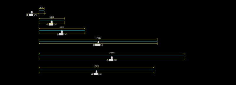

Hi Guys,
Looking at the lisp above its very similar to one that i was also looking for, albeit where rajeshmuthu wanted to add a bar at the end, as irneb noted, we just simply need the dimension dividing by a set distance (say 3000mm for example).
So if we have a dimension of 600mm we have 1 No 3000mm length, 6050 we have 3 No 3000mm lengths, etc, but also leave the orginal dim in the dimension line.
Apart from the additonal bit of "wish list" for the majority of cases the lisp seems to work fine, however, if you look at the example below for some reason I get the odd one which is incorrect see both dims @ 17000 and 17495??
Any suggestions would be appreciated.
