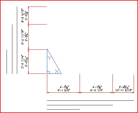

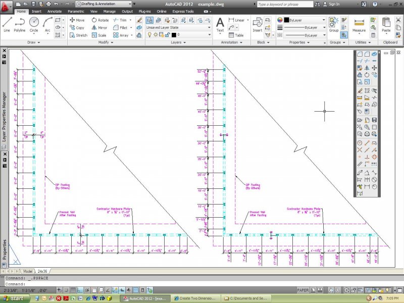

Redheaded Drafter Posted February 24, 2012 Author Posted February 24, 2012 The drawing on the left is what we currently do. The one on the right is what I am trying to achieve. We do a point to point dimension string on cast in place embeds for our General Contractors sakes. Occasionally our own erection crew needs a rogue dimension while erecting. In these instances they have to do the math themselves or call us. Our drafting department (of 2 individuals) decided that it might be useful to have a baseline dimension string in addition to what we have already. So I am looking for the most efficient way to do this. Quote

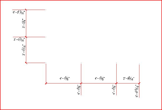

Dadgad Posted February 24, 2012 Posted February 24, 2012 (edited) PSSorry it took so long to respond, we have been swamped for the past few months! I have figured out a way to do this, as shown in the attachment, but I am not so sure it is the best way. I have added a field to the dimension in the text formatting toolbar. Unfortunately the field must reference two points, only one of which may be in the dimension. This necessitates drawing a line, the endpoints of which will define both points. Using the OBJECT setting in the FIELD dialog box, you can then select the object, and the attribute, LENGTH which you want to insert in the field. I have separated the lines so they will be visible. They would probably want to be on a non-printing layer. This method is tedious, as each field needs to be keyed to the appropriate straight line. If you try to set it up as a dimension style, the field will be lost. You can copy the dimension, or make a block of it, but each time it is used, the reference will need to be refreshed to the correct line. I think a better way to go about it is the use of 2 distinct dimensions. The first being your normal dimension, and the second being a baseline dimension, but with the baseline spacing set to 0. In order to display as shown in your right hand drawing, set the baseline dimension test position to horizontal, and your text offset to whatever you think looks the best. This is a much safer way to do it, as you needn't worry about the very repetitive resetting of the field reference to extra lines, which are also extra work. Edited February 24, 2012 by Dadgad Quote

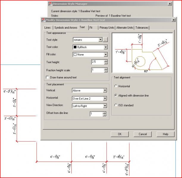

Dadgad Posted February 24, 2012 Posted February 24, 2012 You will need to have different baseline styles for the 2 axi, so that they display correctly. The values for your X Axis baseline dimension style will probably look something like the ones in this attachment. Quote
