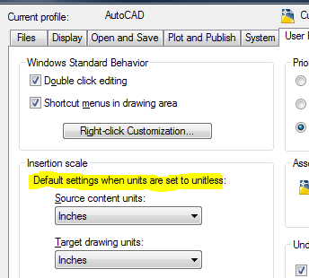

options>user settings>source drawing unit and target drawing unit
i guess you mean this is inside autocad settings

tools > option > user preference > insertion scale
its just the same with changing format > unit > insertion scale
i`ve made both of them same with the unit i set on inventor.. but the result is just wrong in dimensions
thanks
tools > option > user preference > insertion scale its just the same with changing format > unit > insertion scale
format > unit > insertion scale sets the INSUNITS system variable
tools > option > user preference > insertion scale sets the INSUNITSDEFSOURCE & INSUNITSDEFTARGET
Controls the default scale for inserting blocks and drawings into a drawing.
Source Content UnitsSets source content units value when INSUNITS is set to 0.
(INSUNITSDEFSOURCE system variable)
If Unspecified-Unitless is selected, the object is not scaled when inserted.
Target Drawing UnitsSets target drawing units value when INSUNITS is set to 0.
(INSUNITSDEFTARGET system variable)
I think what kampret06 is trying to say is the 2 have the same effect. The defaults are used when InsUnits=0, otherwise InsUnits takes precedence.
But it sounds from his description as if he has done everything correctly: i.e. Inventor set to mm, InsUnits=4 (mm), InsUnitsDefSource=4, InsUnitsDefTarget=4. With those settings there should be no variation in scaling between Inventor and ACad. Not using Inventor, I can't say for sure. Though I've got Inventor Fusion together with my Vanilla Acad 2012 and it seems to not give troubles of this sort - no need to fiddle with SAT files either, just click Open in Inventor / Open in AutoCAD.
Perhaps ADesk had some issues between these 2 programs and fixed it with fusion.
