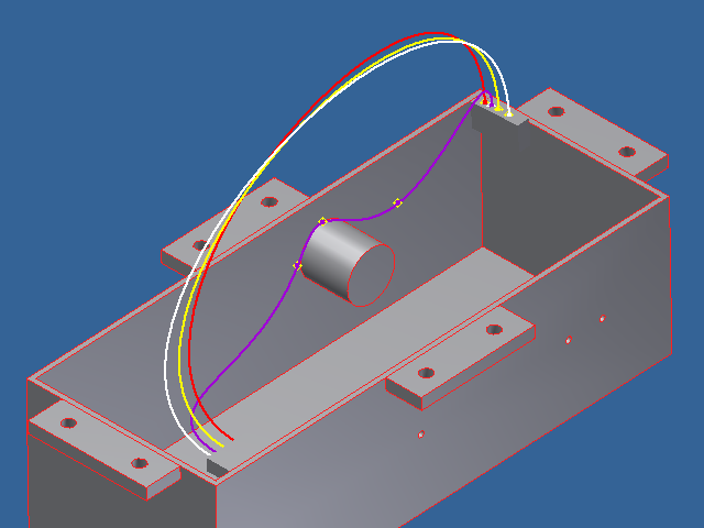

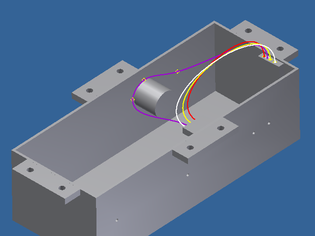

Simple Example:
KC
If you route a cable then Inventor will auto-route the wires.
