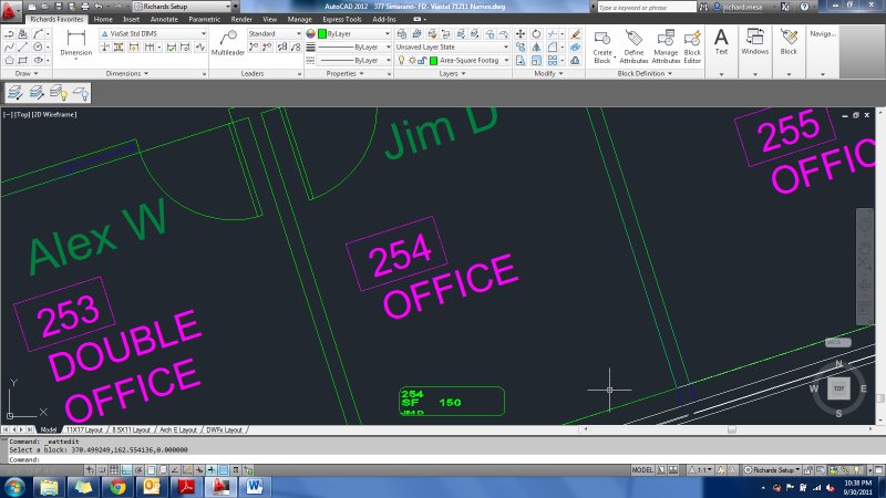

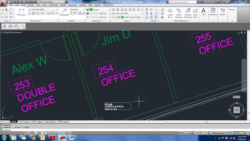

Upload a piece of drawing shows before and after of your needs ( or an image) .
Ok , invoke the routine and select ( for example ) text ( Alex and 253 and double-office ) and after that select the attributed block which is as I can see
in your images in office No# 254 .
And insert the same name of the attributed block that you have already selected to be inserted with the new texts .
Oh I think I figured it out.
Basically I have to re-insert the block after I run the routine. Am I correct?
Of course .... :)
Awesome! Any way to change the order of which names get inserted where? If im pushing my luck just let me know :)
I really knew that you'd ask this question . :)
So of course yes there is a way , but you have to select each text a lone ( one by one ) . What you think ?
