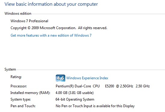

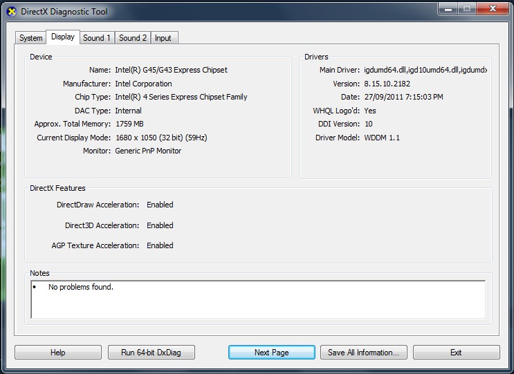

Have there been any issues with inventor running very slow? All I was doing was trying to rotate a simple 2D shape. My machine isn't the most powerful out there, but it def. isn't the crappiest either. I know AutoCAD had some graphics acceleration which was slowing everything down. Does Inventor have any extra options which I can turn off or users have turned off in the past? Thanks.
Sarosh
You might want to post your computer specs.
What else do you have running concurrent with Inventor?
Computer specs are attached. As for other programs, I am just running Microsoft Powerpoint and a Firefox browser with a couple tabs. The object I was trying to work with is also attached if anyone wants to experiment.

PC specs:
Operating System: Windows XP Professional x64 Edition (5.2, Build 3790) Service Pack 2 (3790.srv03_sp2_gdr.101019-0340)
Processor: Intel® Pentium® III Xeon processor (4 CPUs), ~2.8GHz
Memory: 8190MB RAM
Display: NVIDIA Quadro FX 1700
Display Memory: 512.0 MB
And almost everyday I encounter CRASHES...

Garbage in = garbage out. You want this as one curve. I will post example if I get a chance. Keep in mind that the best curve has as few points as possible.
Right mouse button while editing your sketch and select Show All Constraints. (a thousand coincident constraints? not good?)
