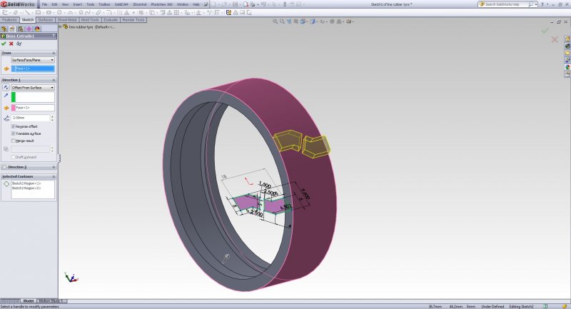

endlasuresh Posted October 7, 2011 Posted October 7, 2011 (edited) I made a tyre and want to pattern it. I am using revolve round boss/base but this is not allowing me to draw on the tyre. I am attaching the file so let me know where to start the sketch on this tyre. My solidworks is 2010 version line rubber tyre.zip Edited October 8, 2011 by endlasuresh Quote

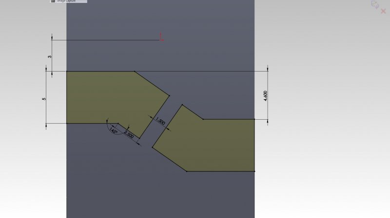

shift1313 Posted October 10, 2011 Posted October 10, 2011 suresh, what are you trying to do with that sketch? There are some issues with your sketch that prevent some things from working. Some of your lines overlap leaving these issues shown in the images. In order to extrude these you have to select regions but i suggest you fix your sketching. Stable sketches are the basis for all your models. On the left side of the sketch your tread block is outside of this tire. This prevents you from starting the tread on the tire or splitting it with your tires surface. If you fix these sketch entities you can use the "from" section for your extrude and select your tire outside, then "to" offset from surface. Quote

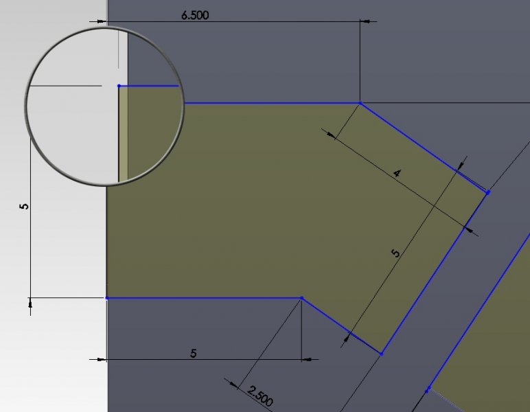

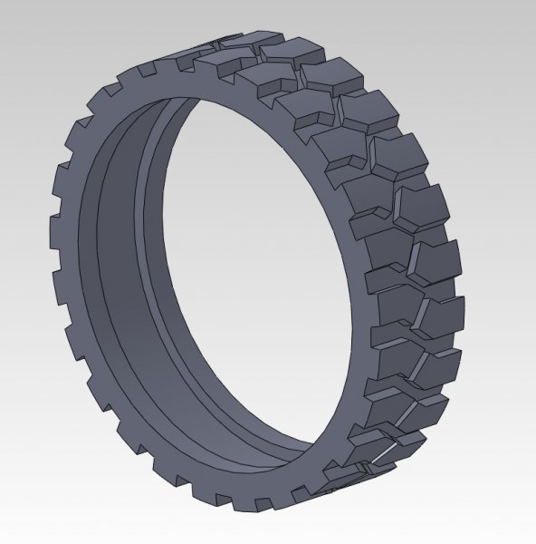

endlasuresh Posted October 13, 2011 Author Posted October 13, 2011 matt thanks for the screenshot I have did but the space between the patterns is different. I want the space either 1mm or 1.5 in all directions. While circular patterning I am unable to mention the distance. http://www.freefilehosting.net/linerubbertyre Quote

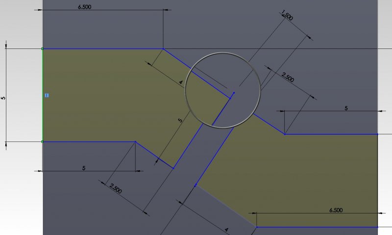

shift1313 Posted October 13, 2011 Posted October 13, 2011 (edited) you will have to figure out how many treads you need to make that offset suresh. if your tread is 5mm wide and you have 62mm diameter tire you have a 194.68mm circumference. To get a 1mm to 1.5mm gap it seems you get somewhere between 30 and 32. Unfortunately the way your tread block sketch is drawn they don't nest together well. You will need to reconsider your sketch to make this work properly. also take a look at the image below. You need to use more relations in your sketches and not rely so heavily on dimensions. It will simplify your sketch and changes later. I added lots of parallel, colinear, equal and perpendicular constraints. Edited October 13, 2011 by shift1313 image added Quote

shift1313 Posted November 29, 2011 Posted November 29, 2011 Suresh, im still not sure how to help you. If you really want to make the tire in 1/4 sections the treads are going to be tapered so much on the outside ones that it may not work. What you can do is create some planes at 45degrees to use as a pull direction and simply use the Draft feature after you have drawn the tire as above. Will this solve your problem? Quote
