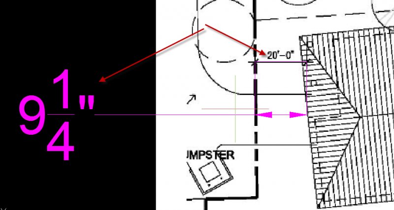

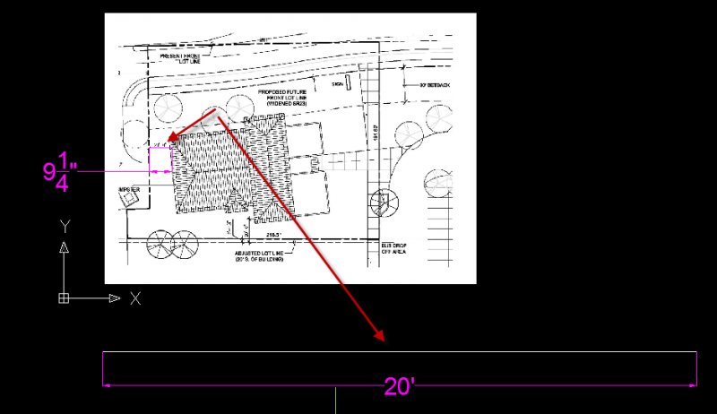

First image: known distance of 20' equals 9-1/4" however the 9-1/4" is irrelevant here...

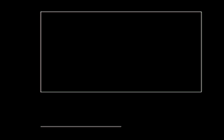

Second Image: Line is drawn actual 20' Using (S)cale ®eference and selecting the entire image I will make the 9-1/4" (reference line) 20'

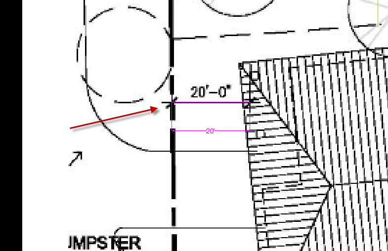

Third Image: Now reference line and the image dimensions match...
