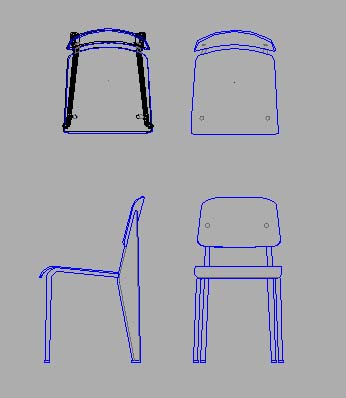

Loutro Posted October 12, 2011 Posted October 12, 2011 I've done something strange and cannot figure out how to solve it. I downloaded a 3D file of a chair and within the file I copied the object three times in order to create three paraline views (plan, side elevation, and front elevation. By way of changing the views, I turned each copied object until it appeared properly on the screen--this of course changed the ucs for each view. After flattening and overkilling, then simplifying each drawing to a satisfactory state, I was ready to print to pdf. Moving to paper space, I created a viewport for each of the three views, but for some reason, the scale could not be set properly: even setting the scale to 1:1, the object became very tiny on a letter sized sheet. I checked the measurements in model space to be sure that I hadn't scaled anything, and everything is fine there. Problem 1. Why can't I set the scale properly in paper space to print at a reasonable size (scale should be about 1:10 or 1:20)? I decided to go back to model space to try to re-orient each drawing so that they are all in the same plane, but I could not rotate as needed. The screen shows one drawing properly (ie. x and y are in the normal position), but the other drawings appear as simple lines, one vertical and one horizontal. I know that I need to rotate each 90 degrees and then change the view, but I am unable to rotate. I have never worked in 3D cad before and clearly am missing basic understanding of how to use it. Problem 2. How can I re-orient all three drawings so that they are in the same plane, and reset the USC to the standard position so that the z axis is not a factor? I want the document to be a simple 2D cad file with the three views of the file lined up properly next to each other. I have attached the file. It was created using Autocad 2011 (it is a french version, Im hoping it will open without any issues). Many thanks to anyone who can offer any assistance. HM Standard_0000F250zzzz.dwg Quote

eldon Posted October 12, 2011 Posted October 12, 2011 I would suggest that Rotate 3D would do the trick. P.S. ReMark doesn't know about Metric Ants Quote

ReMark Posted October 12, 2011 Posted October 12, 2011 I've added an isometric. Lou: You should have your viewports on a separate layer so the display can be locked. Quote

ReMark Posted October 12, 2011 Posted October 12, 2011 Reorient your UCS using either the Dynamic UCS option or if you want to do it manually use the 3-point option. I'd also recommend rotating any 2D view that isn't already in the "default" X/Y UCS to it. The 3D chair can stay "as is". eldon posted a screen shot from the looks of it. Quote
eldon Posted October 12, 2011 Posted October 12, 2011 thanks, did you attach the updated file, or is this a screenshot? It was just a screen shot to show what Rotate 3D could do. I leave you to explore the command. Quote

ReMark Posted October 12, 2011 Posted October 12, 2011 There are at least four different ways to change the viewport scale. Click on the viewport then... 1) Change the scale in the Properties dialog box. 2) Use the Viewport Scale feature in the lower right-hand corner of your screen. 3) Use Quick Properties. 4) Via the Viewports toolbar. Take your pick. Quote
eldon Posted October 12, 2011 Posted October 12, 2011 Going back to your viewport problem, I think that your viewport is sized in millimetre units, whereas you are drawing in metre units. Quote
