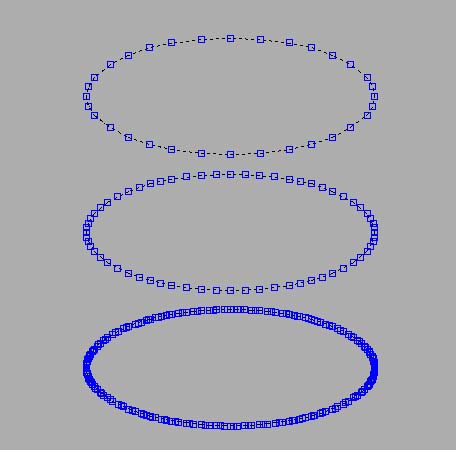

ColinPearson Posted October 14, 2011 Posted October 14, 2011 (edited) **I can't type today - title shouldread Pellipse Resolution **LOL, still can't type... I know this should be easy, but can't figure out yet. How do I change the resolution of a pellipse so that I can get many nodes for import into FEA? Thanks all, and keep in mind that the weekend is CLOSE! Edited October 14, 2011 by ColinPearson Quote
eldon Posted October 14, 2011 Posted October 14, 2011 I am making this up as I go along, but as far as I know, Pellipse only enables a Polyline to be drawn instead of an ellipse. There is no facility to increase nodes. However, I had a go, and by successively using Pedit with the Fit Option, then exploding the polyline, and rejoining with Pedit, the number of nodes does increase. Quote

Dana W Posted October 15, 2011 Posted October 15, 2011 I am working with an old version of AutoCAD, so there are new buttons that I have never heard of. Perhaps you could guide the OP to these new buttons and give a before and after screen shot to demonstrate the effect of more segments, shown by more grip nodes. Now that I am on my computer with AutoCAD available..... The answer to my own question in post #3 is Nope, nothing to do with it, won't change anything except how the elipse looks when you need a regen. The answer for the OP's question is, change the value of the system variable PELLIPSE to 1. First, F1 pellipse then read. Pellipse = 0 - Creates a true ellipse object and has grips only at center and each axis end. Pellipse = 1 - Creates a series of joined polyline arcs with a grip at each end and midpoint of each arc. Quote
eldon Posted October 15, 2011 Posted October 15, 2011 I suspect that the OP had already found out that by changing Pellipse to 1, the ellipse command was drawing a polyline instead of a true Ellipse. But the OP was wanting more nodes to the polyline - hence my suggestion which would seem to work, unless someone knows better. The process seems to be a reverse Weed. Quote
