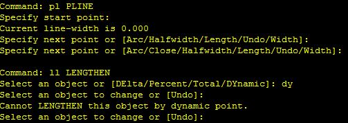

Squirltech Posted October 18, 2011 Posted October 18, 2011 How about the LENGTHEN command LEN and then use the DYnamic option? (example)LEN DY then select the end of a line and pull in the direction you want to lengthen (or shorten) and then enter the distance you want to lengthen. This is what I use but just as a note, LENGTHEN does NOT work on a POLYLINE. Quote

eldon Posted October 18, 2011 Posted October 18, 2011 How about the LENGTHEN command LEN and then use the DYnamic option? (example) Your example only shows a LINE being Lengthened by dynamic option. It does NOT show it working with a polyline Quote
troggarf Posted October 18, 2011 Posted October 18, 2011 For 2011 & 2012 Polylines: Select the polyline Hover over the end-point grip that you want to lengthen Select "Stretch" B to specify a base point Click the end point to specify the old end point move the cursor in the direction you want lengthened (note: there should be a dotted "extension line that shows you when you are lengthening in the direction of the original line) enter the distance of what you want added to the endpoint Quote
troggarf Posted October 19, 2011 Posted October 19, 2011 Your example only shows a LINE being Lengthened by dynamic option. It does NOT show it working with a polyline I have made a new post that shows how to lengthen a polyline vertex or endpoint (found here) ~enjoy Quote
