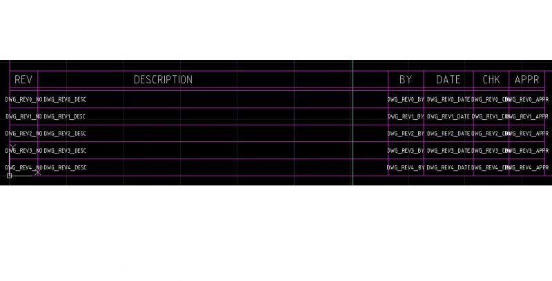

crmosoldier Posted October 19, 2011 Share Posted October 19, 2011 Hey guys, I have been looking everywhere for simple script to edit the attributes in my title block but im not having much luck. What I want to do is edit the revision information in a title block for a number of drawings. I have looked into doing this with a lisp and I have a lisp that works but I have to run this for each individual drawing. The reason I am looking do do this with a script is so I can select multiple drawings using ScriptPro and run the script that way. Does anyone have an example of a script I can use to do this? Thanks!! Quote Link to comment Share on other sites More sharing options...

crmosoldier Posted October 19, 2011 Author Share Posted October 19, 2011 The attributes are as follows: DWG_REV0_NO DWG_REV0_DESC DWG_REV0_BY DWG_REV0_DATE DWG_REV0_CHK DWG_REV0_APPR This group of attributes is repeated 4 more times but with 1, 2, 3 & 4 in place of 0 Quote Link to comment Share on other sites More sharing options...
pBe Posted October 19, 2011 Share Posted October 19, 2011 And how many of these Blocks in a single drawing? Are you wanting to edit the last rev number? or input a new rev? say for example Current Rev is B at DWG_REV_NO2 and you need to put a new Rev which is C at DWG_REV0_NO3? But you cant tell what the current DWG_REV0_NO box number is the latest one? what i meant was there is no way of knowing which DWG_REV0_NO the last one used until you open the drawing. so DWG_REV0_NO will vary from one drawing to another? Quote Link to comment Share on other sites More sharing options...
crmosoldier Posted October 19, 2011 Author Share Posted October 19, 2011 1 block in a single drawing Not exactly sure what your asking but I will try to give you a bit more info and see if you can get what your asking from that. The attributes on the title block are shown in the attached picture. I imagine that if i had a script i would have all of this info in it and for say revision A i would only fill in the values for that row (attributes containing REV0) and then when it was time for revision B i would then fill in the values for the second row (attributes containing REV1). Hope this helps Quote Link to comment Share on other sites More sharing options...

pBe Posted October 19, 2011 Share Posted October 19, 2011 (edited) First look into Gatte the script as folows gatte block blockname TAGNAME NewValue ...... And thats for every Tag name Now for the lisp program with script this will be the first few lines of your script: (setq mlst '("DWG_REV0_NO[color=blue][b]1[/b][/color]" [b][color=sienna]"A"[/color][/b] "DWG_REV0_DESC[color=blue][b]1[/b][/color]" [b][color=sienna]"WHATEVER"[/color][/b] "DWG_REV0_BY[color=blue][b]1[/b][/color]" [b][color=sienna]"ME" [/color][/b]"DWG_REV0_DATE[color=blue][b]1[/b][/color]" [b][color=sienna]"YOU"[/color][/b] "DWG_REV0_CHK[b][color=blue]1[/color][/b]" [color=sienna][b]"HIM"[/b][/color] "DWG_REV0_APPR[b][color=blue]1[/color][/b]" [color=sienna][b]"THEM"[/b][/color])) (setq mlst (vl-propagate 'mlst)) _.open "D:\Path\sheet1.dwg" (RunIt mlst) _.save _Y _.close _.open "D:\Path\sheet2.dwg" (RunIt mlst) _.save _Y _.close where the one in red are the numbers you need to change and the blue ones aer the literal string /new string (defun RunIt (lst) (setq aDoc (vla-get-ActiveDocument (vlax-get-acad-object))) (vlax-for itm (vla-get-ModelSpace aDoc) (if (and (eq (vla-get-objectname itm) "AcDbBlockReference") (eq (vla-get-effectivename itm) "[b]YourBlockName"[/b]) ) (mapcar (function (lambda (j) (if (setq AtM (member (vla-get-tagstring j) lst)) (vla-put-textstring j (cadr AtM)) ) ) ) (vlax-invoke itm 'GetAttributes) ) ) ) (princ) ) Hope this helps Edited October 19, 2011 by pBe Quote Link to comment Share on other sites More sharing options...
