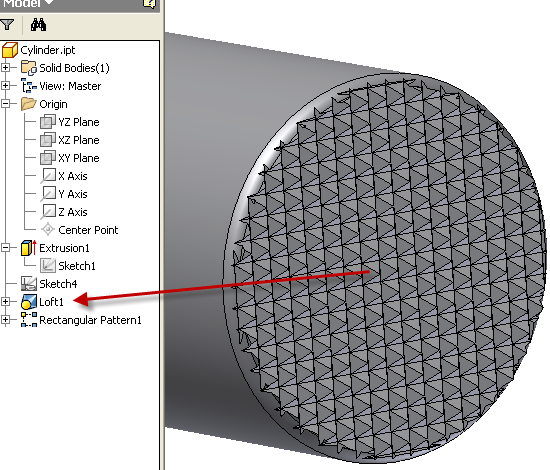

[ATTACH=CONFIG]30638[/ATTACH]
Can anyone show me how to checker a part in Inventor, like the one shown?

Loft to point.
Rectangular pattern
or
use a cosmetic texture.

Did you figure out how to loft to a point yet?
Pattern feature?
