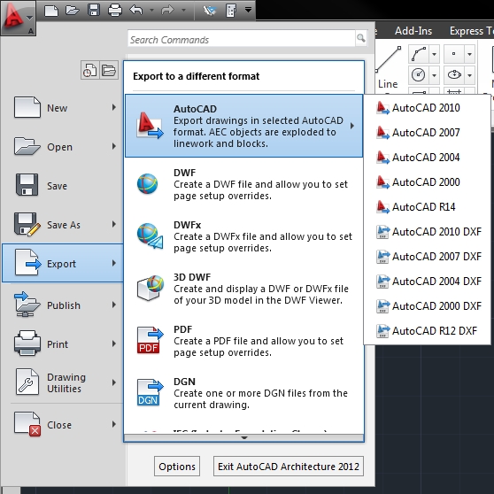

f700es Posted October 20, 2011 Posted October 20, 2011 Once you are finished with your design simply be in a plan view and then Export to AutoCAD (under the big red A). This will export your acad arch model to a flat, 2d cad file. It will also explode all of your intelligent walls, doors and windows. So be just be aware of this. The export does leave the original arch dwg in place so you can make changes. Quote
