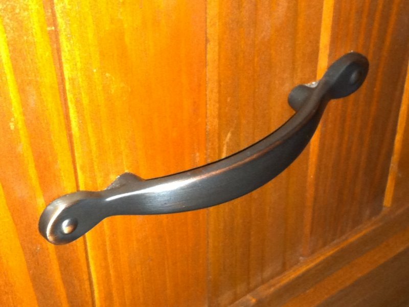

RJB Posted October 26, 2011 Posted October 26, 2011 Hello, I am quite new in AutoCAD world... How can I draw a furniture handle in 3D. I drew handle using polyline and trying to convert it to 3D but I am being prompt that objects are not planner... any advise? Any other ideas? Please help. Quote
iskalipsi Posted October 26, 2011 Posted October 26, 2011 There are many handles out there. Can you post a reference pic, so we'll know where to start. Thanks. Quote

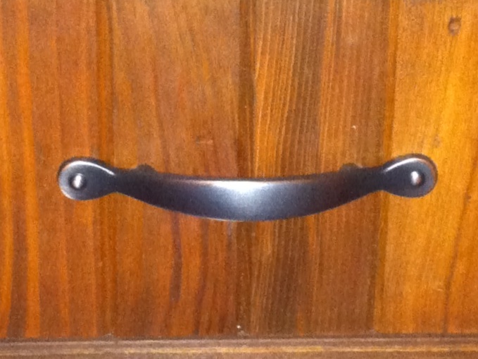

RJB Posted October 26, 2011 Author Posted October 26, 2011 Here are pictures of handle I need to draw... It's a small furniture handle with 3" center to center. Quote

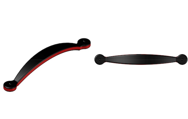

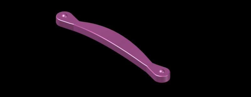

ReMark Posted October 26, 2011 Posted October 26, 2011 This is a "rough" mock up (I had no dimensions to work with so I made up my own) of your handle in 3D showing a side and top view. I could have smoothed out the edges either in the initial profiles I used or via the Fillet command and I could have radiused the transition between the ends and the main handle body but I didn't. It was basically constructed using the method I previously stated. Oh, I used a sphere to create the "bump" at the end. Maybe I'll refine a bit more if time permits otherwise this should prove it can be done. Quote
ReMark Posted October 26, 2011 Posted October 26, 2011 OK. I spent a little more smoothing it out some. Here is the result. It's as much as I am going to do. Hope it is of some use to you. Quote

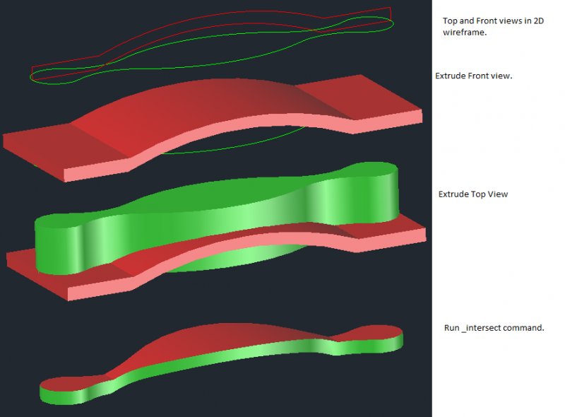

JD Mather Posted October 26, 2011 Posted October 26, 2011 (edited) If you do a traditional 2D front view and 2D top view (on respective planes), extrude each and then find the intersection this will get you pretty close. Then add cylindrical features for mounting and the fillets. Try these steps and post what you are able to complete if (when) you run into trouble. Edited October 26, 2011 by JD Mather Quote

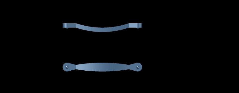

RJB Posted October 29, 2011 Author Posted October 29, 2011 JD, Thank you for directions! I can't believe that it was that easy... This is what I create... Now I would like to give this handle more realistic look. Any hints? Thank you, RJB (^_^) Quote
ReMark Posted October 29, 2011 Posted October 29, 2011 Realism will be enhanced if you apply a material and then render it. Quote
Bill Tillman Posted October 29, 2011 Posted October 29, 2011 Nice work. And as ReMark said, you will need to apply a material like Stainless Steel, or paint either from the built-ins or create your own materials. Then render the item with some lighting. Rendering with the desired lighting is a complete art or science to itself but if you're doing 3D you'll want to learn more about this. JD, that's a pretty slick method there. I learned something from this too. Quote
