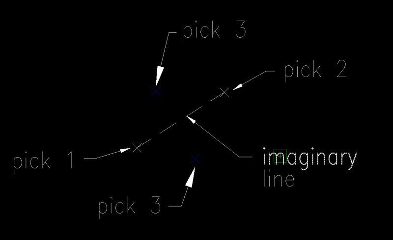

I'm having trouble with a conditional statement and probably you can help me out.
1. I have point A and point B pick.
2. How can I know which side my pick 3 lies on point A and point B.
Thank you!

You have nine possible results for this query, the four compass directions N,S,E,W four quadrants NE SE SW NW or the point is on the line. Is that what you are trying to discern? -David
;; Side of Ray  -  Lee Mac
;; Args: pt - test point, l1,l2 - points defining ray
;; Returns:
;;  0 if pt lies on ray
;; -1 if pt is right of ray
;;  1 if pt is left of ray
(defun LM:SideOfRay ( pt l1 l2 / x )
   (cond
       (   (equal (setq x (sin (- (angle l1 pt) (angle l1 l2)))) 0.0 1e-14) 0)
       (   (minusp x) -1)
       (   1   )
Thank you ALL and to you Lee. Works as I envision it but it only on the WCS. Well it doesn't matter since I'm a having trouble with my points anyway. After I'm done with my routine, I'm planning to make it work on all viewports, so I need a little help with polar points with trans function. Autodesk reference guide just confuse me on trans.

You can also use the area of a triangle...
(defun AT:TriangleArea (a b c)
 ;; Returns area of three provided points
 ;; If returned value is negative, last point (c) exists on right side of a-b vector
 ;; Alan J. Thompson, 06.09.10
 (/ (- (* (- (car b) (car a)) (- (cadr c) (cadr a)))
       (* (- (cadr b) (cadr a)) (- (car c) (car a)))
    2.
Thanks pBe. I'll also include this on my artillery of sub routines. How can I live without you guys. Thank you very much!
