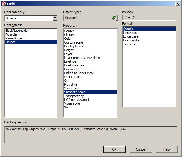

I have been through all of the system variable field sources but cannot find one that stores the scale of a viewport. I want to add a field to my drawings that prints the viewport scale and updates it automatically if and when I change the scale. Does anyone have any suggestions? Thanks

I just spent 6 hours printing sticky lables and manually labeling my plan sheets with scales that I forgot to update prior to the print job. Never again!! That is a great help!

You're welcome.
