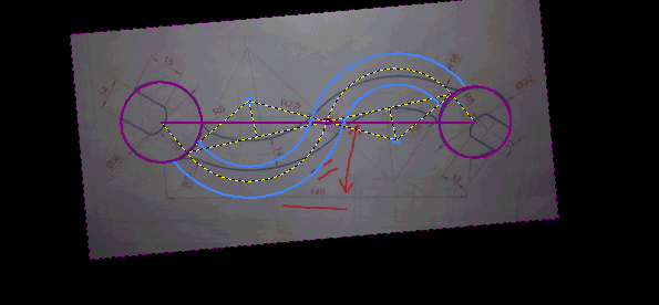

I can't find the original thread, but eldon pointed out a week or so ago that this problem had infinite solutions with the information given.
In m original solution I found I made an additional assumption that resulted in a unique solution.
I thought I should clarify that with the given information, that eldon was correct about infinite solutions.
Hopefully this animated gif will show the parametrically defined problem.
Thank you very much for taking the time to investigate further. It is nice to know that, as yet, I am not going completely doolally.
The original thread did have an odd title, but hopefully, we got there in the end :D
