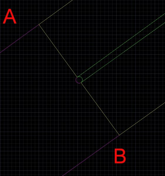

Just out of curiosity, how is the distance from A to B determined? I'm assuming that the circle is the turbine tower and the the green pline the area that is blocked.
Is there a set inclusion angle for a radar beam? -David
Hello David. It's a total of .45 deg from the center of the radar location. (.225 either direction from the center) You are correct, the circle is the turbine tower and the green is the blocked beam beyond.
David, it just occurred to me that I didn't really answer your initial question. The way I did it was to draw a line from the center point of the column (circle) perpendicular to the outside beam on both sides. Come to think of it, that's probably slightly off. I think that line would actually need to be parallel to the position of the radar at that moment. That's something I'll need to work out.

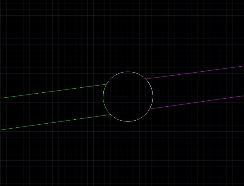

Just because I thought it an interesting exercise:
1) When the turbine tower takes up more than 0.45 degrees of beam angle ( the tower is very close to the radar tower ), the obstruction area grows larger than 0.45 degrees beyond the turbine. ( an example of your 1st drawing attached. )
