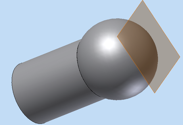

pjmac Posted November 4, 2011 Posted November 4, 2011 I am trying to create a plane on a round surface. is this even possible? i want to be able to extrude holes through a ball towards the center. Quote
JD Mather Posted November 4, 2011 Posted November 4, 2011 turn on visibility of the sketch you used to create the sphere click workplane and select the line you used for Revolve and the endpoint of the line at the arc Quote
pjmac Posted November 7, 2011 Author Posted November 7, 2011 when i do that all i get is a horizontal plane wherever i select the point on the arc. Quote
Bishop Posted November 7, 2011 Posted November 7, 2011 when i do that all i get is a horizontal plane wherever i select the point on the arc. You might need to drop a work point on top of the sketch point first. I have a hard time getting a tangent plane using a sketch point. I think it's possible to do, but for some reason I can't ever actually select the sketch point. If you put the work point down, then hit the work plane button, you can select everything much more easily. Quote
JD Mather Posted November 7, 2011 Posted November 7, 2011 Attach the file here. I never have any trouble selecting sketch point and arc or line to get perpendicular plane. Quote
pjmac Posted November 7, 2011 Author Posted November 7, 2011 sprayball.ipt I must be doing something wrong Thanks JD Mather Quote
Bishop Posted November 7, 2011 Posted November 7, 2011 Attach the file here.I never have any trouble selecting sketch point and arc or line to get perpendicular plane. JD - I don't have any problem doing it that way either, but I don't think that's what he's trying to do. I think he's selecting PLANE --> TANGENT TO SURFACE THROUGH POINT. That's the part where I have trouble selecting a sketch point, myself. Quote
Bishop Posted November 7, 2011 Posted November 7, 2011 Interesting file ... I can see the preview of it, but can't open it in Inventor Pro 2011. Quote
pjmac Posted November 7, 2011 Author Posted November 7, 2011 JD - I don't have any problem doing it that way either, but I don't think that's what he's trying to do. I think he's selecting PLANE --> TANGENT TO SURFACE THROUGH POINT. That's the part where I have trouble selecting a sketch point, myself. That is what is happening when i do what JD Mather suggested. I want the sphere to be the work plane. Quote
Bishop Posted November 7, 2011 Posted November 7, 2011 Wait wait waitwaitwait. You want the surface of the sphere itself to BE the work plane, or you want the work plane to be tangent to the surface? The sphere itself cannot BE the plane, since it is not planar. (Forgive me if I misunderstood your last statement.) If what you want is for the work plane to be tangent to the surface of the sphere, put a work point down on the sketch point that's at the surface. Then you can put the work plane down. Quote
JD Mather Posted November 7, 2011 Posted November 7, 2011 Interesting file ... I can see the preview of it, but can't open it in Inventor Pro 2011. That is because it is an Inventor 2012 file. Quote
JD Mather Posted November 7, 2011 Posted November 7, 2011 I must be doing something wrong Thanks JD Mather Your Sketch1 is not constrained to the origin - read this http://home.pct.edu/~jmather/skillsusa%20university.pdf Quote
JD Mather Posted November 7, 2011 Posted November 7, 2011 WorkPlane1 and WorkAxis1 are not needed (they already exist in the Origins folder - simply constrain sketch1 to the origin as covered first day of class). Quote
Bishop Posted November 7, 2011 Posted November 7, 2011 That is because it is an Inventor 2012 file. Grumble. I can't wait until our IT Dept decides that 2012 is bug-free enough to let us have it. Quote
pjmac Posted November 7, 2011 Author Posted November 7, 2011 Alright i want the work plane to BE the sphere, so thank you JD Mather and Bishop and i hope i did not take up to much of your time. Quote
JD Mather Posted November 7, 2011 Posted November 7, 2011 Alright i want the work plane to BE the sphere, so thank you JD Mather and Bishop and i hope i did not take up to much of your time. Uhmmm, how can a sphere be a plane? (Geometry 101) You are doing too much work - see attached. Perhaps what you really want is to project to a sphere? Sprayball Rev1.ipt Quote
pjmac Posted November 7, 2011 Author Posted November 7, 2011 Perhaps you are right. Thank you also for the essay you wrote i will learn a lot from that. Quote
