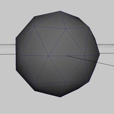

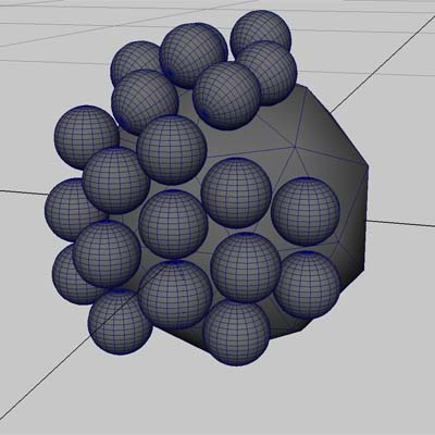

mikeymore Posted November 7, 2011 Author Posted November 7, 2011 Yesss, thanx seant, thats exactly what I ment. I also found on the web that a sphere with equel parts is called a Dodecahedron. See images, I made in Maya. Now is the question, how to make a certain sphere in Acad and assign a sphere on each part???I cant do it with 3D array isn't?? Quote

mikeymore Posted November 7, 2011 Author Posted November 7, 2011 @theralsaint: Thanks for the post, but thats not exactly what I ment. The spheres must have exact the same distance to eachother, so on every side of the sphere. It can be made by a Dodecaheron, exact the same triangles on every point of a sphere. I can made in Maya, by hand, but I want to do it the exact way in Acad. @JD mather: My Acad file wasn't that important, thats made by a sphere and some lightbulbs I want to connect to it. That was before you told me that it is a polyhedron (I am newbee to this mathematical stuff) I just want to attach lightbulbs (but in cad a sphere is also good enough) exact to the middle of each triangle. My questions: 1) how to make this sphere in Acad? 2) Can I attach (by array or something) a sphere in the middle of the triangle, or do I have to do this by hand?? Thanks all for the replies! Quote
mikeymore Posted November 7, 2011 Author Posted November 7, 2011 Oops I posted a reply, but its lost.... Anyway, thanks for all the replies, the only thing that I want to know now is: Can I change the params in Acad to make such polyhedron?? I am quit new to CAD. I want to put on the centre of each triangle a sphere. Do I have to do that by hand?? I guess it can snap with a point on the sphere with the centrepoint of the triangle? @jack-oneill: actually the triacontakaienneahedron won't be it.... I also have troubles to say the dinosaurs names in my sons dino-book haha Quote

SEANT Posted November 8, 2011 Posted November 8, 2011 AutoCAD does not have any native commands to produce that polyhedron – as primitive geometry. Those shapes can be modeled(i.e., multi step process), see this thread as reference: http://www.cadtutor.net/forum/showthread.php?50206 I used the model in that thread to derived some Arc/Triangles that may offer a basis for further geodesics type analysis. Perhaps spheres could be positioned by copying to the appropriate osnap point. Automating the process further would require custom programming. Geodesic.dwg Quote
