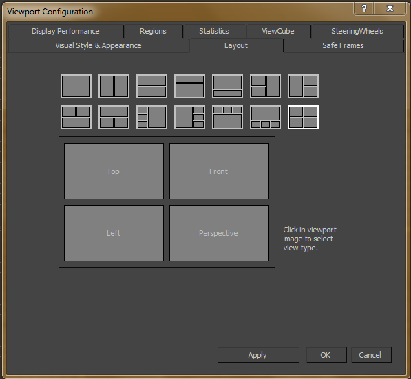

here have fun.. to set as the default startup...
Click RIGHT click the button on the lower right corner
after click that button click layout on the window that appears
you should now see this
