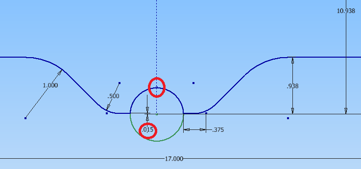

These are the only dimensions needed to fully constrain this area of the sketch (use Symmetry, Equal =, Coincident constraints).
Did you intend this .015 offset?
Is your design intent for the blue arc to also be offset .015 bigger than the green projected circle?

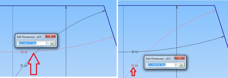

These are some "oddball" angles.
Are these really what you want?
Is width and height the controlling design intent dimensions or the angles?

Dimensions in Sketch 1 where done with Auto Dimension button. I seem to have problems finding the missing dimensions to fully constrain sketches sometimes. I have since constrained sketch 2.
No I didn't intend for the .015 offset. How did you get that dimension. I just tried to find the .015 and i cant get it to show.
Design intent is for the for blue arc to be same as projected circle.
Yes, the width and height are controlling those angles. I also don't like it when "oddball angles, lengths, etc." are used.
Never mind, I just found it. Its the bottom to center of circle. Didn't intend for it, but its a non issue with final outcome of part. Its going to be plasma cut when finished. So tolerances will only be as good as that anyway.

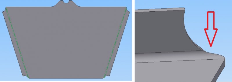

Because you have some bends going through these cuts - some special considerations will need to be made.
Let me know when you are ready to work through this step-by-step (I don't have 2011 - so you will have to follow pictures and written instructions).
I see you are here - so I'm going to give a suggested solution (I don't like that this part is not symmetrical about the origin, and I would not suggest that a beginner use Adaptive techniques (the red blue arrows) but I'll ignore those problems).

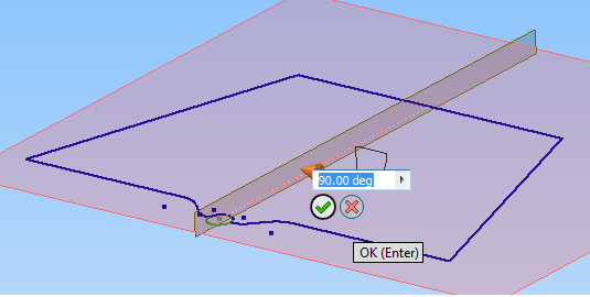

Create a WorkPlane by selecting the construcion centerline in Sketch1 and the XY-Plane in the browser.
Click OK

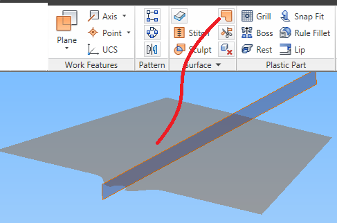

Create a Boundary Patch surface using Sketch1 as shown.

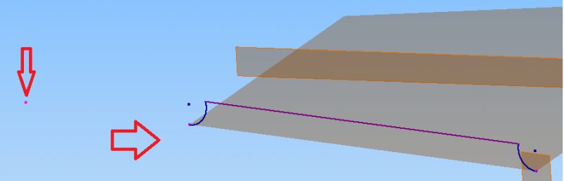

Edit Sketch2
Delete the extraneous point shown and delete all sketch geometry below the boundary patch as shown.

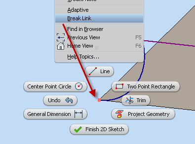

You will see a pink dot (sick geometry) remaining on each arc.
Right click on these dots and select Break Link (your screen will look slightly different than mine as I'm using 2012).

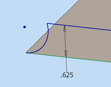

Project Geometry the edge of the Boundary Patch and add dimension shown.
