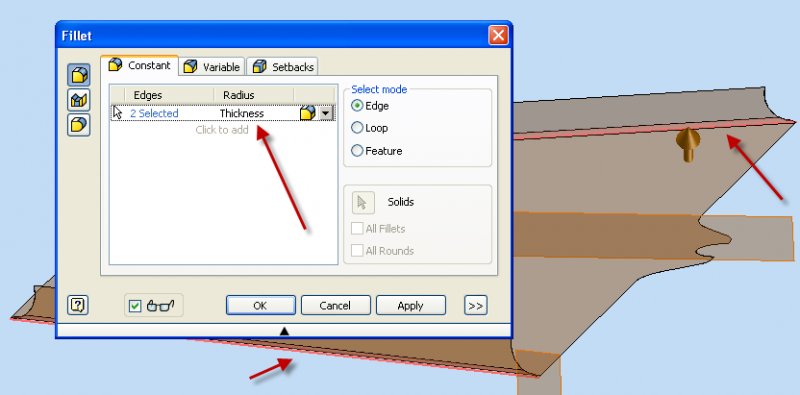

JD Mather Posted November 7, 2011 Posted November 7, 2011 Add Fillets for the bends with Radius Thickness as shown. Quote

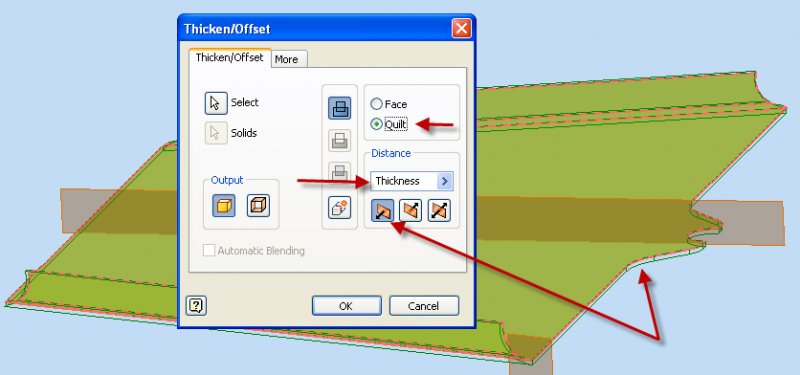

JD Mather Posted November 7, 2011 Posted November 7, 2011 Thicken the surface Quilt by distance Thickness towards the outside as shown. Turn off the visibility of the stitched surface. Quote
