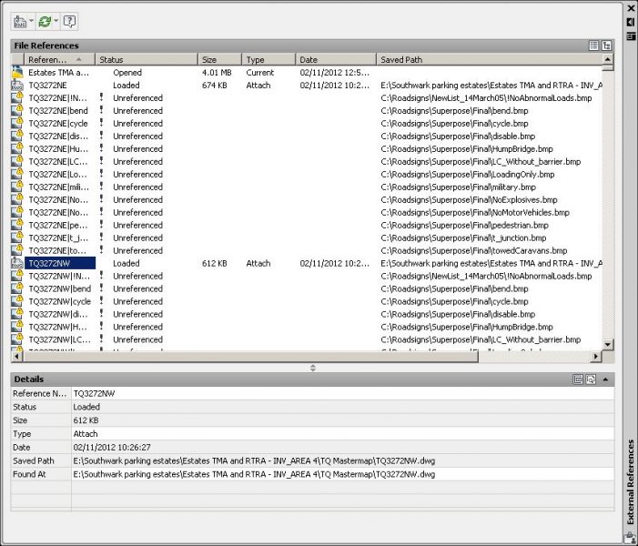

Lee,
I get the following (see attached image) when I type xref at the command line.

OK, so your XRef is inserted with a Full Path and is also found at (and hence loaded from) the given Saved Path.
@Lee,
Yet when I use the XRR it does not load the x-references? Is there some setting that I am missing?
The External References list in your image looks huge with a vast number of unreferenced image files; are there perhaps other XRefs further down the list that are not found?
Here is a 'verbose' version of the program to inform you of the status of each XRef encountered:
