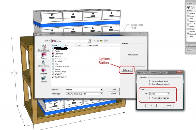

How do I transfer autocad drawing to sketchup with its exact scale??? it does not appear 1:100m in sketchup.. the dimensions are not the same... or do I need to rescale the drawing at the SU? THANKS
What scale is your AutoCAD drawing? You should have drawn full scale in AutoCAD and insert full scale in SU. Can you post the file?
When you import the DWG file there will be an options button on the right, click on it to set inport scale.
[ATTACH=CONFIG]31066[/ATTACH]
thanks! great help! :)
