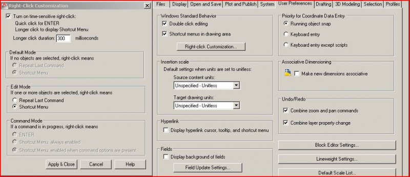

Many commands have command specific right click shortcut options available which can be incredibly helpful. I am guessing that you will have used some of them before. Autocad 2012 has changed the default right click shortcut menu considerably, the CLIPBOARD dropdown contains basic edit tools. The ISOLATE dropdown can be useful too. It seems from your last post that you already have them enabled, should you wish to explore other right click customizations, you can do so in OPTIONS > USER PREFERENCES > RIGHT CLICK CUSTOMIZATION as shown on the attachment.
^ Thanks! I'm aware of that. I only use right click as "Repeat my last command" and Enter besides the right click "snap on" menu.
Right clicking into Publish empty Dialog Box wasn't intuitive for me to figure it out on my own I guess.
