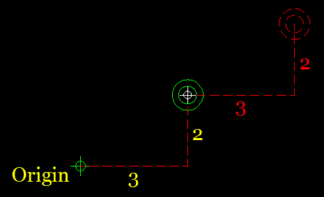

(command "move" obj "" p1 pause)
when the command reaches 'pause' If I right click (to keep the object in same location) instead of left click, the object automatically moves to some strange location. Same is the case with copy command. I noticed same happens even if we use the commands manually. This happens with all the entities line/pline/block etc.
Can somebody explain this behaviour of AutoCAD.
Thanks.
When right-clicking at the prompt:
Specify second point or <use first point as displacement>:
You are selecting to: .
This means the vector from the origin to the first selected point is used as the displacement vector.
e.g.
Just cheat and use the acet-ss-drag-move function (if you have Express Tools).
eg.
;; (acet-ss-drag-move <selection-set> <base-pt> [<prompt>] [<hilight> [<cursor>]])
(defun c:test (/ ss p1 p2)
 (if (and (setq ss (ssget "_:L"))
          (setq p1 (getpoint "\nSpecify base point: "))
          (setq p2 (acet-ss-drag-move ss p1 "\nSpecify second point: " T))
   (command "_.move" ss "" "_non" p1 "_non" p2)
