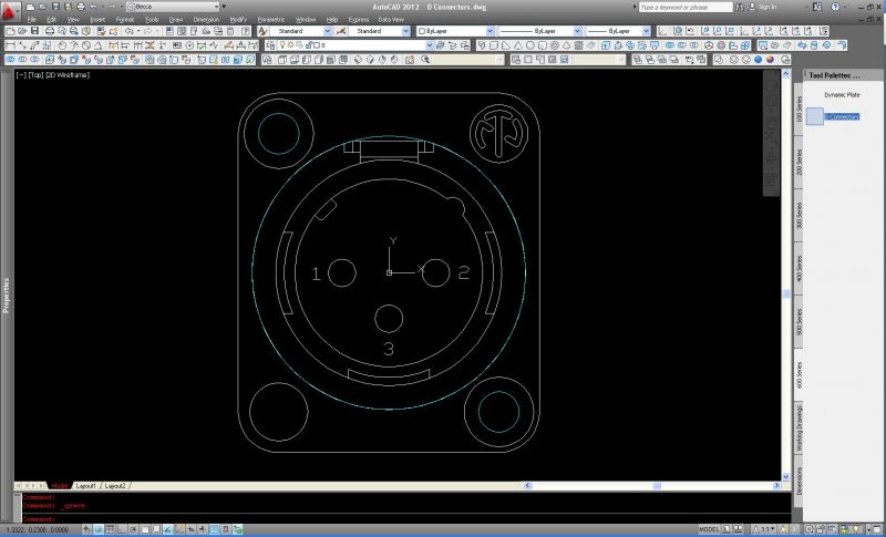

resullins Posted November 18, 2011 Author Posted November 18, 2011 (edited) Ok... one more question... Why do my block images on my tool palette like NOT EXIST? They're tiny, and I don't know how to fix that without manually drawing and replacing all the images. The second block in the tool palette at the right IS the block you're looking at, and it's saved exactly like you see here. Edited November 18, 2011 by resullins ETA the actual picture, since I'm a dumb***. Quote

resullins Posted November 18, 2011 Author Posted November 18, 2011 Nope... tried that. And there's two that are doing it. It's almost like their extents are set improperly, cause when I open them, they're VERY TINY. But when I actually "ZOOM" "E" they zoom in at the right size. I'm having issues today. Now, I have another problem I can't seem to solve.GRRRRRRRR.... I'm trying to make a dynamic block array another dynamic block. It doesn't work. It worked in my head. Quote
BlackBox Posted November 18, 2011 Posted November 18, 2011 I'm not sure that I understand the issue with the tool palette thumbnails... the associated image *should* simply be the thumbnail that is last generated the last time the drawing is saved, and has nothing to do with the LIMITS set within said drawing. What happens when you revise the drawing as desired, then drag it (the revised drawing) onto your tool palette in lieu of attempting to refresh the image? Quote
resullins Posted November 18, 2011 Author Posted November 18, 2011 I don't understand it either. But basically, (you can't see this in my screen shot) you can see a thumbnail, but it's basically one pixel. Like the file has something REALLY tiny in it. I've drug it back onto the tool palette multiple times, and there's nothing there but one dot. Quote
BlackBox Posted November 18, 2011 Posted November 18, 2011 Last idea(s): Have you tried WBLOCKing the problem drawing to another, and adding that to your tool palette? Even when working from our template, I tend to do this to strip the unnecessary, duplicate data from tool palette source drawings. Have you tried removing the problem item(s) from your tool palette, to include the cooresponding images in the directory, and adding the revised drawing to the tool palette? Quote
resullins Posted November 18, 2011 Author Posted November 18, 2011 Nope. Tried that, too. Have removed and re-added, have tried resaving with a different file name, nothing. Quote
BlackBox Posted November 18, 2011 Posted November 18, 2011 Nope. Tried that, too. Have removed and re-added, have tried resaving with a different file name, nothing. Yes, but what about using the WBLOCK command specifically? Quote
resullins Posted November 18, 2011 Author Posted November 18, 2011 Tried that. No luck. And any image I use that's specified from an image file doesn't show up well enough. You can't see anything. Quote
