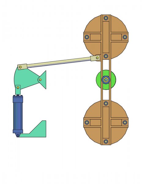

I there a way to connect the 3D solids of this drawing and define the pivot points so that when you move one part all parts react accordingly?
I have never tried this in Autocad before.
Yes
