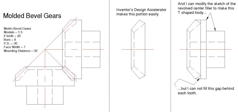

Gary Barker Posted November 18, 2011 Posted November 18, 2011 I was able to create the bevel gear TEETH relatively quickly. But there is more to a bevel gear than just teeth - there is the cylindrical shank and the shoulder - and that is where I am having trouble... We need a 3D model of these little 1.25" diameter 20 tooth bevel gears in order to have them plastic molded. I was able to modify the sketch of the revolved center portion of the gear (the next to the last step generated by the Design Accelerator) to get most of the added cylindrical shank and shoulder shape I need. But I am having trouble "closing the gaps" to get a model that I can fillet and draft for molding. Here are the two problems... 1) picture a revolved T-shaped "body" below the gear teeth. How do you create a solid fill between the flat top plane of the T-shaped gear body and the curved back side (bottom side? large end?) of each of the 20 gear teeth? 2) how do you get the gear teeth and the revolved solid that connects them all be one solid piece? (I think they are not connected because I can't cut away any portion of the gear teeth, but I can cut away portions of the revolved solid) Any help is appreciated, even it if is a referral to a video or a book. Thanks! Quote

Gary Barker Posted November 19, 2011 Author Posted November 19, 2011 Thanks JD! I many years of AutoCad experience, and a few years of ProE time. I'm using a friend's Inventor to see how I like it. So far no problem using it for simple molded parts, but this little gear is a big headache. I don't have access to the machine to get a IPT file tonight, but here is a JPG that shows the problem area. Hopefully it is self-explanatory. We need to fill the spaces behind each tooth so there are no undercuts in the molded part. Quote
JD Mather Posted November 19, 2011 Posted November 19, 2011 This is so trivially easy in AutoCAD, Pro/E or Inventor that I feel I must be missing something. I will have to see the ipt file. Quote

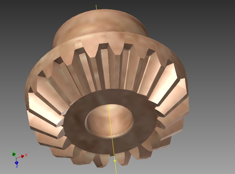

Gary Barker Posted November 20, 2011 Author Posted November 20, 2011 I think I figured out how to shrink the smaller file enough. The larger version I can only send a picture of. My first message was not very clear. I can "fill the undercut", but NOT in a way that is simple and elegant and clean enough to allow the drafting and filleting that I need to do to make a plastic 'mold-ready' part. So the IPT file called "First Try" just used projected geometry to fill the gap. Pretty easy, but its not the style I want, And even with this "simple" fill method I then can not put clean fillets all around the teeth and shoulder. (I suppressed most features to get the file size small enough. Start turning them back on at Revolution 3. Do not turn "Fix Body" or "Pitch Diameter" back on) The attached picture shows what I want the teeth to look like, especially how the outer back of each tooth extends out to be part of the 32mm diameter shoulder of the body. I did a lot of crude steps to get it to look like this, and you can maybe see that the valley between each tooth does not actually line up with 32mm shoulder. On neither of these models can I do all the filleting I want for molding - it's like the teeth edges don't connect perfectly with the revolved body, or the teeth have some sort of constraint that interfere with filleting. So what I want is a gear model that is solid and connected enough to then draft and fillet. I was thinking about starting with the face length longer and just cutting away some of the inner and outer edges of the gear - but I don't know if changing the face length will alter the tooth geometry so much as to cause other problems... Bevel Gear - First Try.ipt Quote

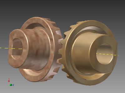

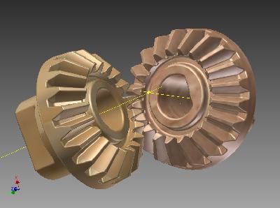

Gary Barker Posted November 22, 2011 Author Posted November 22, 2011 Everything about modeling these gears worked MUCH better when I made the very first revolved solid (the one the teeth are cut from) into the final B1 shape we wanted. Otherwise the Design Accelerator leaves the individual teeth floating unconnected and then later tries to mate them back up with a revolved body - which causes problems for drafting and filleting. Also making the revolved gear body early let's you put in relieved areas to get better wall thickness consistency for molded parts. Here are pictures of the final gears - fully drafted and filleted and ready for molding... Quote
Bishop Posted November 22, 2011 Posted November 22, 2011 Gary, what's the mottled reddish-whitish texture you used on the one gear? I've got a material that I've not been able to get the texture to look right for, and that right there looks just about perfect, if I made it grayscale instead of color ... Quote
JD Mather Posted November 22, 2011 Posted November 22, 2011 Looks like carpet-brown to me (at scale). Maybe cork or cardboard. Quote
Gary Barker Posted November 22, 2011 Author Posted November 22, 2011 They are different Wood tones. I think one is birch and the other is ash. The wood tones really help the 3D features stand out on small parts like these. But not so good on big parts... Quote
