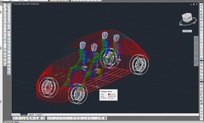

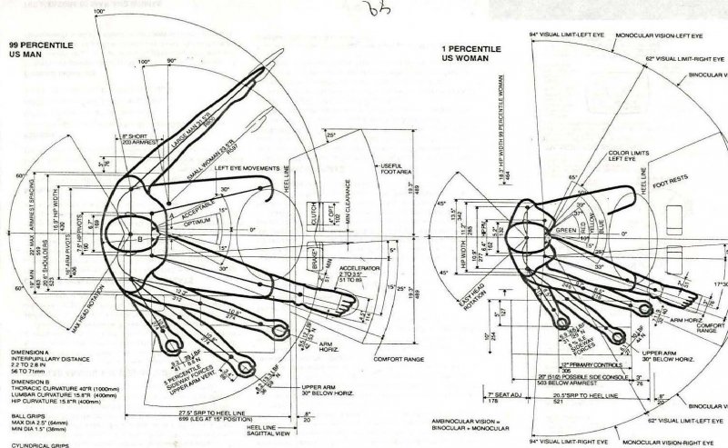

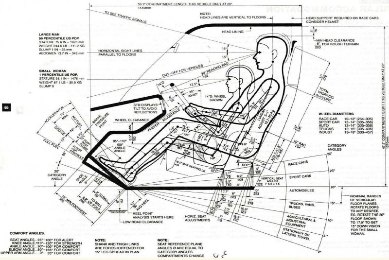

fotisnafplion Posted November 21, 2011 Author Posted November 21, 2011 First of all, I think I have collected the information I may need for this project (included 2 old projects similar to mine, Society of Automotive Engineers International rules, many related papers etc). In addition I have downloaded and read the "visual basic for dummies" book. Of course the designing part comes first. Professor told me that I could use a car designed by another student in autocad so that I can have more time to work on the internal car design and ergonomics. I ll post some pictures showing you the autocad designed car and some critical dimensions I am supposed to use. I finally want to thank you all for your interest. You have already been very helpful. Fotis Quote
fotisnafplion Posted November 21, 2011 Author Posted November 21, 2011 Here are the pictures I mentioned before. If you think that I should post something else too let me know. Quote

JD Mather Posted November 21, 2011 Posted November 21, 2011 (edited) Do you really need this in 3D - or can you do as 2D similar to the image you posted? That would be much easier - using 2d blocks and parametric constraints in AutoCAD. In any case, a first attempt at it in 2D will help you in figuring out how to do it in 3D (the drivers seating height is only a 2D movement in one plane - not like you are trying to show reach to a gearshift or some other control changing as seating height changes). In other words - don't put off the assignment waiting for that presentation/documentation to become available - learn about AutoCAD parametric constraints now. Edited November 21, 2011 by JD Mather Quote
fotisnafplion Posted November 21, 2011 Author Posted November 21, 2011 Yes, I really need to do it in 3D. The image I posted gives me some of the dimensions I need to start drawing. I will certainly try it in 2d firstly. Actually I have already started trying it. You were right when you mentioned that the driver's seating height is a 2d movement but as you can see in this image a shorter driver would not reach the gearshift that easy. In my final project I d like to show that a short driver should adjust his seat so that his hand reaches the gearshift easily too. I don't know. Your thought sounds fair. It's not clear to me either what I have to do. I am meeting professor on Friday morning. I will ask him for more details. Quote
