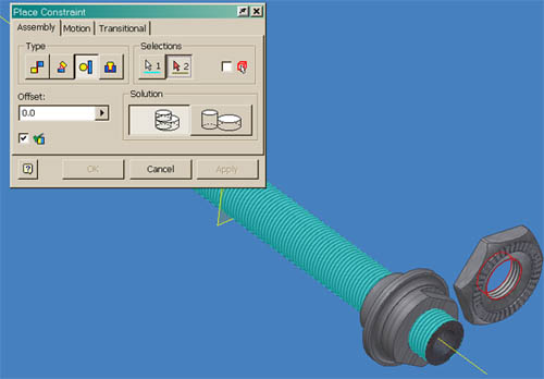

BikeGuy Posted October 19, 2008 Author Posted October 19, 2008 Thanks for the suggestion on constraints as related to animations. I used a tangent constraint (see picture for those of you who also want to learn this also). Now the parts do rotate in the animation (which I can't upload because it's too big). But the tangent constraint is not as precise as constraining cylinder axes. The tangent constraint allows the nut to 'jiggle' with relation to the cylinder. Did I misunderstand your post about a pin constraint, or is this just the nature of the beast? Secondly, is there a way to reduce the size of animation files? I tried both ends of the compression quality scrollbar and the .avi file is more than 2500k even when zipped. I appreciate all the great help here. hubtest.zip Quote

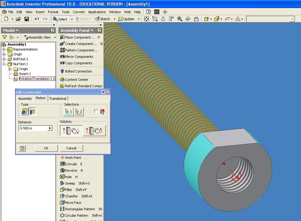

shift1313 Posted October 20, 2008 Posted October 20, 2008 okay i played with it really quickly when i got in this morning so no comments on the model:) I used two constraints and got it to animate correctly. I used a Pin constraints, selected the nut first and the threaded rod second. Then i used the rotation/transitional constraint second. selected the nut first for the rotation, and the threaded rod second for the transition. The first selection is the "child" and the second is the "parent" typically. Then for the animation i animated my pin constraint from 0 to -5inches in my case. because of the rotate/transition constraint this made the nut rotate as it moved. The dimension you put for the rotate/transition constraint will be how far it travels in 1 turn. I set in to .5" but really for 1/2-13(like i drew) it would be .076" per revolution. here is a screen shot and animation. Quote

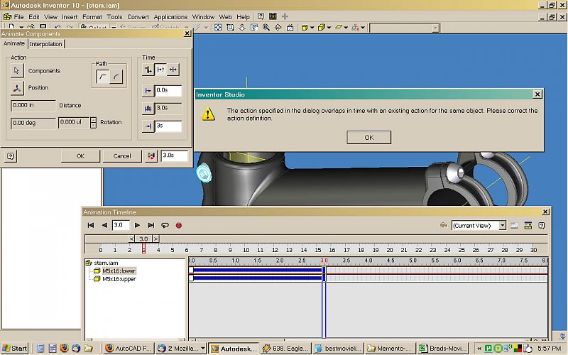

BikeGuy Posted October 23, 2008 Author Posted October 23, 2008 Shift sorry for the confusion. I was waiting until I had enough posts to create a reply with web links. Every reference that I've looked into has taught that presentation files are the place to create animations (by exploding and creating an .avi of the re-assembly). I've looked through my books ('Autodesk Inventor Inside and Out' and 'Autodesk Inventor Essentials Plus') which also say to use presentation files. You can see what I am trying to do in this tutorial. http://www.youtube.com/watch?v=YhYYZTGi6JY&feature=related http://www.youtube.com/watch?v=YhYYZTGi6JY&feature=related It's in two parts and if you watch carefully you can see that he made a small mistake. Anyway though, I tried the method you suggest in assembly views and I can understand it a little (it's similar to 3D Studio), but not enough to make two component animations run at the same time. All of the component animations appear to run in one Is there a good learning resource for this? How does everyone who does animations feel. Is presentation or assembly view the better option Quote
shift1313 Posted October 23, 2008 Posted October 23, 2008 sorry bikeguy as i am probably not the best reference for this, but when i animate components like the thread/nut i did above, i expand the drawing tree on the left, right click on the constraint i want and use the animate constraint button. The error you received above means you are trying to animate the same constraint in two different ways at the same period of time. The animate component is what i would use if you were say bringing that nut in from a distance away from the part. The inventor studio that i use is typically what you would use to check motion simulation of an assembly(i think) and check for clearance issues. The presentation file is like you said what you would use to show assembly(i think). When trying to move two components at once you just need to make sure their times overlap. This should work as long as they are not the same component. ill check those videos out later today and reply back. Quote
