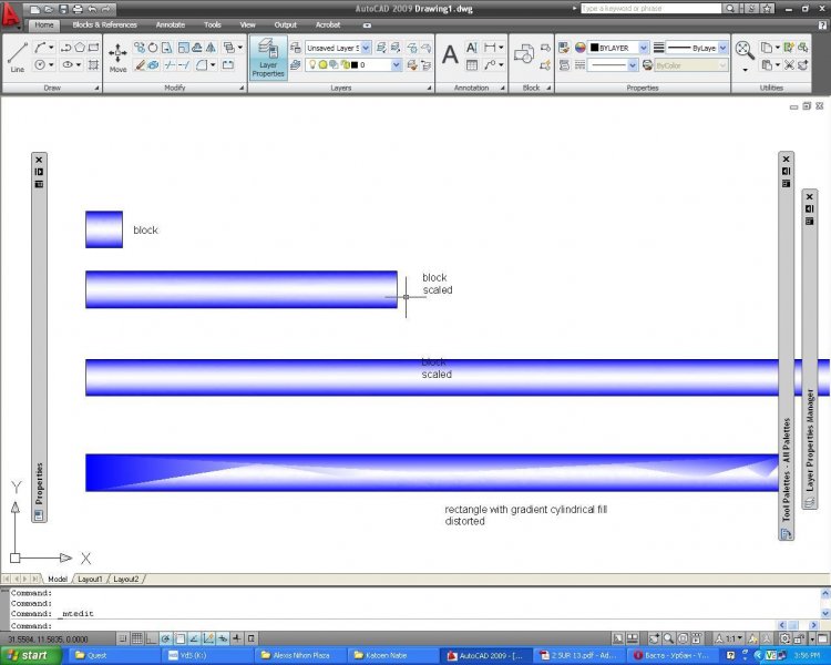

Hello ppl, I have a million pesos question, I often use gradient cylindrical fill to paint pipes, however if gradient has to fill wide boundry it gets distorted, i found the way of making a short block and scaling it, gradient fill is consistent. It's ok but i want to make a dynamic block out of it and i cant, also if i explode this block gradient fill problem reappears (see pic)
Basicly i want similar looking hatch but without problem.

That is an interesting question. I tried it and got the same results as you. Couldn't see any obvious solution.

Yes, I know you want to make it a Dynamic Block but why can't you continue to use a scaled block? It seems to work no matter how much it is scaled.

I draw a lot of those "pipes", meaning a rectangle of specific length and width. Since,i get this annoying problem with hatch i had to brake long rectangle into pieces and hatch each sections in rectangle and than delete the lines as a boundry that i created, plus many objects for one pipe is a bit messy.
than i made a block,place where pipe starts,manually measure the req'd pipe distance and punch it i x scale tab.
than with the help of this forum i come up with a lisp that inserts and scales the pipe block.
Dynamic block will give me and option of modifying the length by two grips (2ways), access to visibility option.
First of all i not very familiar with dynamic block, but i've tried. When block is at its original size its dynamic properties work,when scaled these props disappear.
