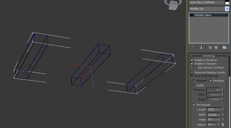

i would like to know if its possible to full with color - put texture at Autocad line drawing by 3dsmax?
i attach a picture of my project in orden to explain better what i mean!
i want to put color at these columns and i m totally irrelative with 3dsmax so i need your help!

How did you create those in Autocad? It appears that they are just lines, not solid objects.
yes they are just lines!!its true!i have the outline of a whole church (line drawings)! what do you suggest?

So you have an entire church that was drawn in 3D with lines? Why didn't you create it with solids or surfaces? You're going to have to reconstruct it. There's nothing you can do with it in it's current state.
