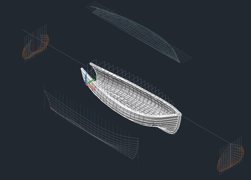

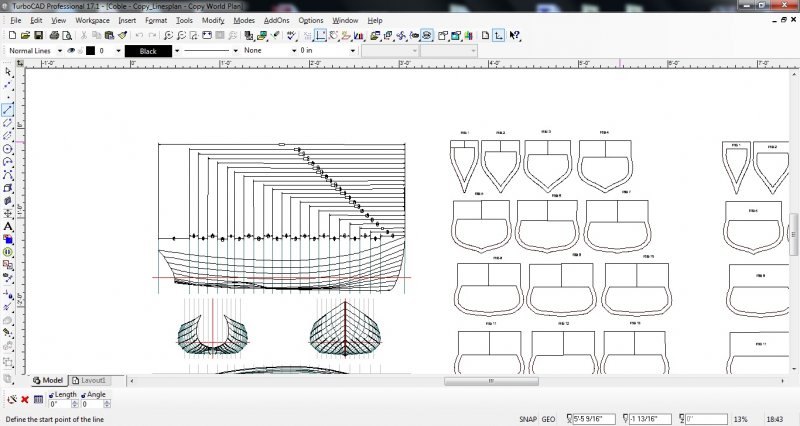

F4TCT Posted December 1, 2011 Posted December 1, 2011 Hi all, im not sure where to start here so here goes.. I currently use Turbocad Pro 17.1 (ok i know this is an autocad forum but hear me out), now using this and another piece of 3D software called freeship, I drew up a copy of my friends fishing boat based on measurements in which i had taken. I have basic 2D skills. Im sure we all know a wooden boat is made of frames and planks. The boat in question is a Whitby Coble - google it. Freeship allows the planks to be printed off or exported into CAD. What i would like to do is basically turn the frames that i have drawn, into 3D. From there i would like to assemble them in order and then basically turn the planks to 3D and wrap them round the frames! This serves a few purposes - firstly they need tweaking, secondly, the frames need to be notched to accept the planks! Freeship does not support clinker built boats. Cobles are clinker built which means plank on plank and the frame or ribs, are the last to be installed. Im after anyone who can help me on Autocad or on Turbocad as i have access to both. Ive seen this done before but i just dont know where to turn. Dan Quote
ReMark Posted December 1, 2011 Posted December 1, 2011 You want to use your 2D cross-sections to create the 3D framework of the boat right? AutoCAD's LOFT command should be able to handle that aspect. The planking may be a little bit more involved. Quote
F4TCT Posted December 1, 2011 Author Posted December 1, 2011 yeah, im pretty sure I can make the frames 3D, the main issue is the planks and manipulating those to fit the frames. Quote

SEANT Posted December 1, 2011 Posted December 1, 2011 I agree with ReMark; definitely looks like a loft operation. Post the file if you can. I’m eager to give it a shot. . . . there are probably others as well. Quote

SEANT Posted December 2, 2011 Posted December 2, 2011 Dan, I sent you an email. If I can derive a suitable Loft, though, I'd like to post it back here (in this thread). Quote

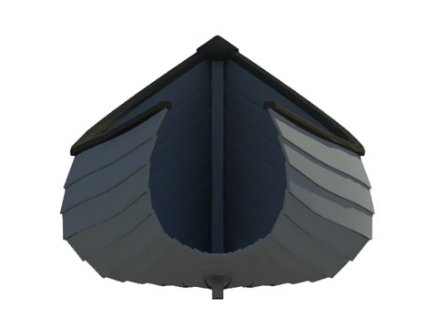

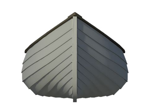

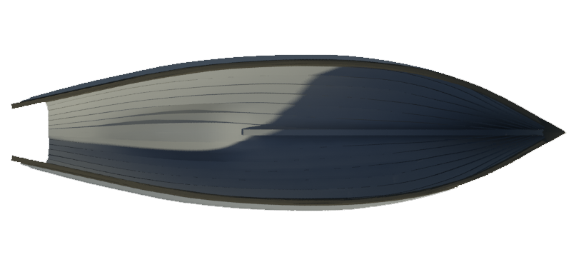

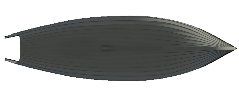

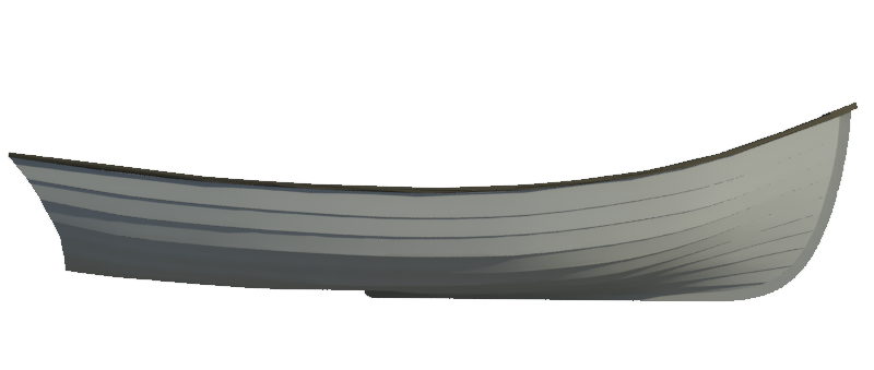

Dadgad Posted December 6, 2011 Posted December 6, 2011 Here is my interpretaion of the data. Very tasty! Quote
