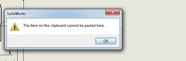

As far as pasting goes - I have tried that and as far as I know SW will not copy and paste image viewws like that. comes up with an error "The item on clipboard cannot be pasted here".....
It appears that you can copy and past the primary views... Just not the section or cut views....

when I try to copy a view lets say 'Section View A-A' it copies via 'CTRL-C' bu when I go to paste it I get this error message...
any suggestions??
