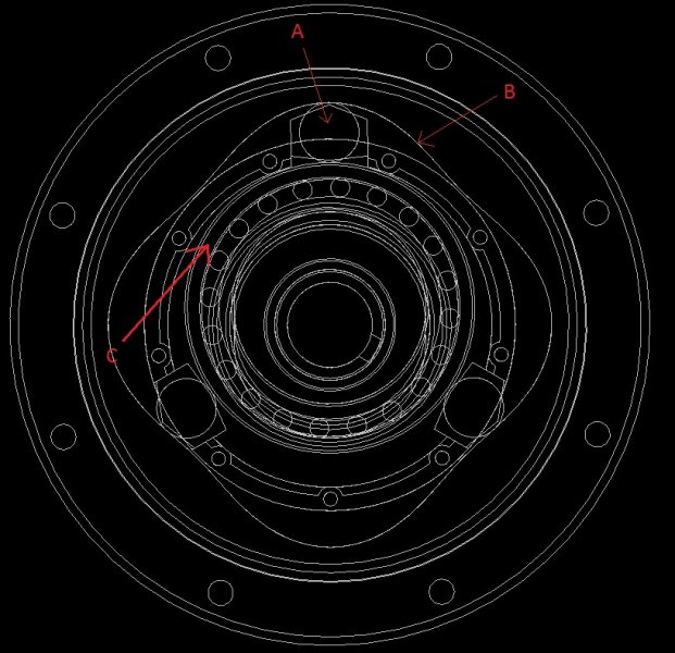

the_system Posted December 4, 2011 Posted December 4, 2011 (edited) Hi people, it's me again. I'm having a lot of trouble with setting up the motions in my assembly, I have been working on it for nearly a week this one problem.... Anyway as you see on the image below, Object 'A' is supposed to follow the path 'B' when you spin the big back wheel. Object 'A' following the path 'B' results in object 'C' spinning as well on an eccentric center. I've tried to design the path so that object 'C' does 4 full revolutions for every 1 the big wheel does. When I apply the motion constrain and set it to 4 ratio, it doesn't follow it correctly, I have tried to apply the constraint many different ways and I found setting it to 4.35 ratio lets 'A' follow for a while but still goes out from the path eventually... I cannot figure this out I have attached the project files and feel free to edit them all you want to get my desired motion, even changing part sizes and etc. It really doesn't matter what the sizes are I just need it to work. I am using Inventor 2012 Thanks for all the help New.zip New2.zip Edited December 6, 2011 by the_system Quote

JD Mather Posted December 7, 2011 Posted December 7, 2011 Wouldn't the Scallop housing be grounded - that is stationary? Do you have Inventor Professional with Dynamic Simulation? I would have used the CAM Generator to create the 4 lobes in Scallop rather than the imported spline. Quote
the_system Posted December 8, 2011 Author Posted December 8, 2011 The scallop is supposed to be spinning based on the movement of the rollers, it should do 1 revolution for every 4 the drive shaft does. I have inventor professional with dynamic simulation, is this the solution to my problem? I have tried to make the 4 lobes using cam generator,I have input all the right data but it just doesnt give me the right curve, I made it harmonic. I found making the curve manually gave me the best fit. The rollers are supposed to be tangent to both the lobes and the bearing/drive shaft. But anyway it doesn't matter because as long as I get the motion right that will be enough. Quote
JD Mather Posted December 8, 2011 Posted December 8, 2011 I don't think you can have it mathematically perfect enough to be tangent to both - so my thinking right now is using contact joints in Dyanmic Simulation. This will allow clearance between parts (which is more like the real world anyhow). Quote
W_Holzwarth Posted December 14, 2011 Posted December 14, 2011 Here's my attempt. I hope, my attachment (only the IAM, parts can be used from before) will come through You can drive by constraint with Winkel:1 Walter Assembled-WH.zip Quote
the_system Posted December 19, 2011 Author Posted December 19, 2011 Thank you so much W_Holzwarth for helping me out heaps, You seem to have solved it perfectly, I have been stuck with it for a while and was feeling down. All I really needed help with was with the motion constraints Quote
