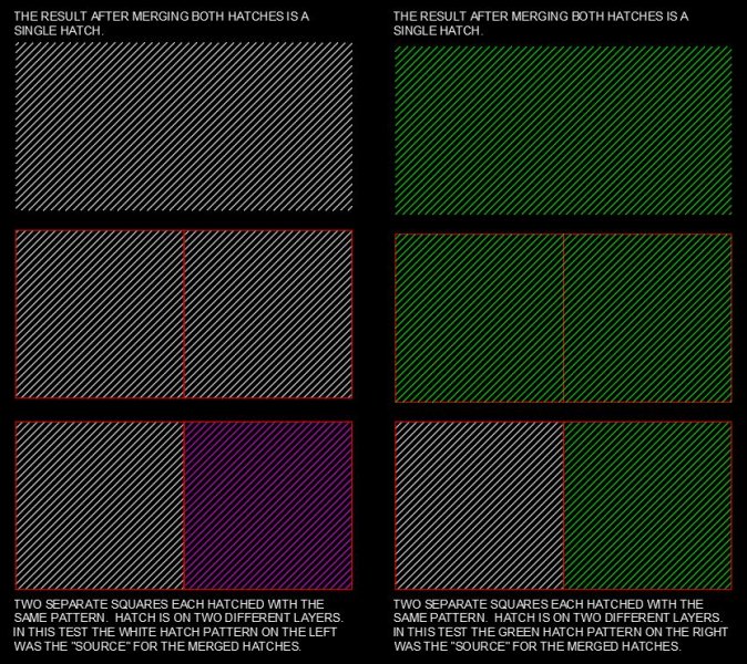

ReMark Posted May 17, 2017 Posted May 17, 2017 (edited) I tried this routine, but it just made the entire Hatch disappear. It worked for me the one and only time I tested it. I cannot say what caused it to fail in your case. Try this one by hmsilva. After loading it type the word "test" (without the quotes) to run the routine. In my test, this morning, it worked just fine. HatchMerge.lsp Out of curiosity I went back and tested the merge hatch routine I previously posted the link to (written by Jvillarreal). Once again it did work for me but the thing I don't like about it is that after the user has picked the first hatch pattern it has to be picked a second time along with the other hatch it will be merged with. So, in my test using two hatched squares I had to make a total of three picks. Using the routine by hmsilva in the same test I only had to make two picks. Both routines work; it's your choice as to which one you want to use. Edited May 17, 2017 by ReMark Quote
ReMark Posted May 17, 2017 Posted May 17, 2017 The results of testing both lisp routines. The example on the left used hmsilva's program. The example on the right used Jvillerreal's. Quote
