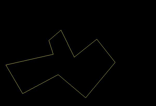

SLW210 Posted December 7, 2011 Posted December 7, 2011 Isn't that how the Stretch command works now, or am I missing something? He wants the crossing selection to go from LEFT to RIGHT, default is RIGHT to LEFT as in your image. Default LEFT to RIGHT only selects objects entirely in the window. Quote
alanjt Posted December 7, 2011 Posted December 7, 2011 He wants the crossing selection to go from LEFT to RIGHT, default is RIGHT to LEFT as in your image. Default LEFT to RIGHT only selects objects entirely in the window. Wow, odd request. eldon's response of using "C" to force crossing is the only viable option - other than just using the software how it's coded. Quote
