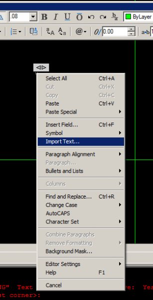

You can also import it...
Hmmm, I can find import, but I can't find "import text" on the ribbon or by right clicking etc.
You find Import Text in the Text Editor, Right-Click or select the arrow button to open options while in the editor.
