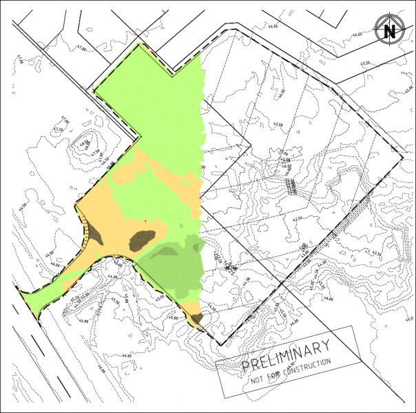

Hi everyone, Ive encountered a bit of a problem on Civil 3D and i cant seem to solve it. The drawing im dealing with has quite a complex surface on it, and it displays fine when im in the model or layout tabs, however when i go to print the drawing, or publish it to PDF, some of the surface wont display, its as if the printer suddenly runs out ink or that type of effect the surface will plot untill a point and then stop. So far ive tried a couple of things to remedy the situation:
- Changed the shade plot (tired all avaliable options)
- Changed the plot style (tired all avaliable options)
- Adjusted HIDEPRECISION
- AUDIT, PURGE, MAPCLEAN
- different paper sizes
- installing update 1 for 2012
- increasing paging file size
- tried different computers in the office
and none of those work, any ideas??
Its ok i have worked out the issue, the printer drivers needed to be updated, im still not sure why it caused the drawing to do this but it fixed it :D
