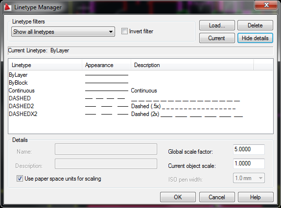

When I draw a line at my template it always has the line type scale 5 as default under properties.
I know that I can chance this by hand or chance a basic line type scale with the command "lts".
But all the lines in the drawings of our partner have the line type scale 1 under properties. So if I used "lts", there would either my lines or their lines be scaled wrong. Also I don't want to chance the default line type scale of each line by hand.
Is there a possibility to set up something that each line I'm drawing, starts with a specific line type scale as default under poperties?

What you're probably looking for is this area of the linetype manager, you just have to unhide it:

I believe the alias command is LINETYPE. At least it is in 2006 haha. I hate old CAD versions :(
Yes, type LINETYPE at the command line. Press Enter.
When the Linetype Manager dialog window appears look to the right where the buttons are. Click on the one that says "Show Details".
Very easy.
Yeah, that'll definitely sort you out. If you can't type LINETYPE in the command line, it's under the Format pull down. May the force be with you :)
Thank you very much. That's what I need. The field "current object scale" had the value 5 in my template. Now I set it to 1 and finally all my lines are scaled the same as my partner's ones.
